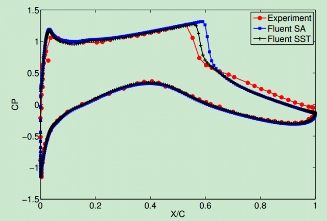

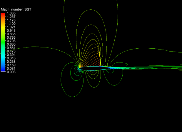

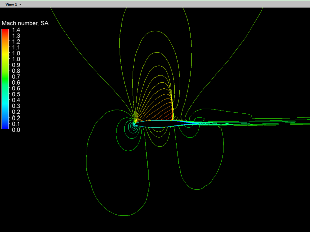

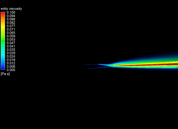

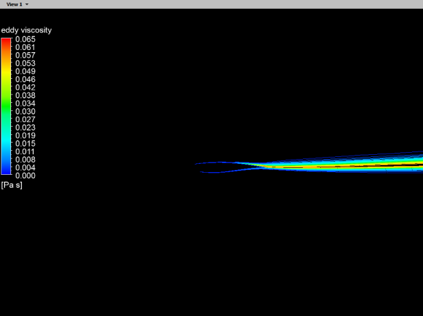

The conve rge d (s ee convergence criteria in the previous section) flows for both SA and SST turbulence mo dels are obtained and shown in Fig.2. Through numerical exp e rime nts, it was found that the setting that affects the final flow most is the turbulence mo del. On the left hand side of Fig.2, the sho ck p ositionfor SST is slightly ahead of that with SA mo del. Consequently, the eddy viscosity for the res ult with SST mo del is a ls o more diss ipate d in the wake, probably due to enhanced mixing. The pressure co efficient distribution for b oth results are compared with the
exp erimental results provide d by cfluid.com in Fig.4. Both SA and SST predicted a sho ck lo cation b ehind the actual one in exp eriment. The dis crepancy  between SST and exp eriment is smaller than using SA mo del. Never the less ,both show significant different in the pressure after the s hock. It is sp eculated by the authors that this significant error is due to the difference b etween the geometry used in the computation and the actual geometry, as the pressure distribution difference seems to close ly relate to the trailing edge shap e. This will b e the topic of further investigation.

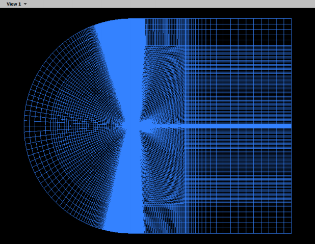

SA模型计算网格
SA模型计算网格
SST模型计算网格
SST模型计算网格
SA模型马赫数云图
SA模型马赫数云图
SST模型马赫数云图
SST模型马赫数云图
SA模型涡粘系数
SA模型涡粘系数
SST模型涡粘系数
SST模型涡粘系数
压力系数比较
压力系数比较
发表于 2015-3-10 14:08:23 | 显示全部楼层
这一枪打的比较漂亮,要是各位参赛者同时提供残差曲线就更完美了。现在有些结果看上去像是没有收敛的结果。
是的,我算得结果都是1e-4左右,其实这个算例接近 buffet, 线性稳定还有待考察。 最近有一些工作在深究这些问题 (transonic-buffet),有进展会在这里发帖继续交流。  详情 回复 发表于 2015-3-14 21:19

我很好奇这个网格是用什么做的,用什么算的,作者的英语真好,赞一个
网格就是简单的 ICEM CFD. 最外面是后来另加的一层网格,因为发现原先的网格远场不够远,影响压力分布。  详情 回复 发表于 2015-3-14 21:15

发表于 2015-3-14 21:15:36 | 显示全部楼层
受教了,你这个网格的光顺性看起来好像很好的样子,不知拓扑结构如何调的  详情 回复 发表于 2015-3-15 13:56

发表于 2015-3-14 21:19:43 | 显示全部楼层
周华 发表于 2015-3-10 14:08
这一枪打的比较漂亮,要是各位参赛者同时提供残差曲线就更完美了。现在有些结果看上去像是没有收敛的结果。 ...
激波抖振需要非定常求解 还是比较难算的 相比翼型的激波震荡导致的抖振现象 我觉得还是由分离涡引起的垂尾抖振现象比较好算 判据比较清晰 例如翼尖弯矩、升力线拐点等  详情 回复 发表于 2015-3-14 21:51

发表于 2015-3-15 13:56:06 | 显示全部楼层
其实就是简单的C网格,只不过流向和发向都又细分了两次。 待会儿把分块贴上来供参考。  详情 回复 发表于 2015-3-15 19:13
发表于 2015-3-15 19:13:54 | 显示全部楼层
