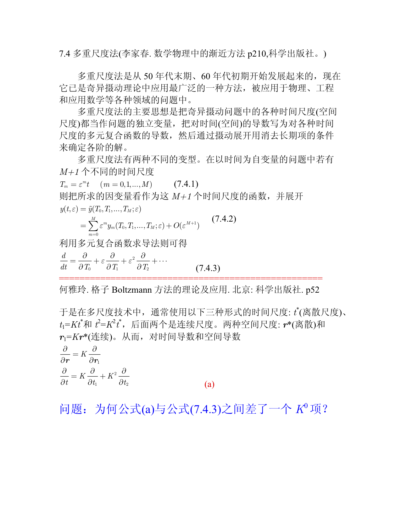

具体问题见附件。

This depends on problem, i.e., what is the leading order K^0 or K^1. What I would suggest you to do is to read some books on kinetic theory -- not those on the LBE (such as the reference 2 you cite).
发表于 2011-2-22 19:55:51 | 显示全部楼层
The mathematical theory of non-uniform gases
Sydney Chapman
网上搜搜 有下载
或者中文的有   气体输运理论及应用/应纯同著/清华大学出版社
数学上源于摄动展开
 楼主| 发表于 2011-2-22 21:23:33 | 显示全部楼层
