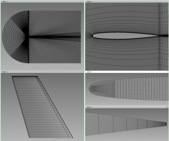

Upp er left: symmetric plane mesh, upp er right: symm etric plane mesh zo omed at the wing ro ot, lo ...

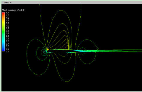

Mach contour at various spanwise lo cations, from top to b ottom: z/b=0.2

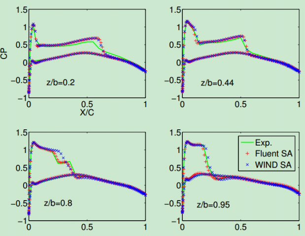

The results from Fluent are in go o d agreement with b oth the results from NASA
WIND co de and the exp erimental results, despite the fact that the geometry
used in this work has a planar wing tip, while for the exp eriment and geometry
used by WIND co de, the wing tip is rounded (Fig.11). Since there flow is highly
three dimensional near the wing tip, why this difference in the wing tip shap es
do es not seem to have a strong effect on the sho ck lo cation is sub ject to further
investigation.

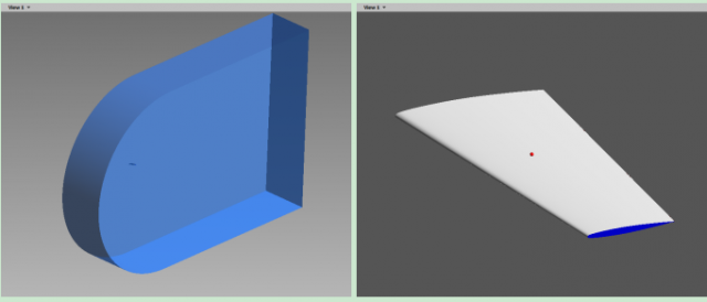

Left: overall computational domain; right: ONERA M6 wing.

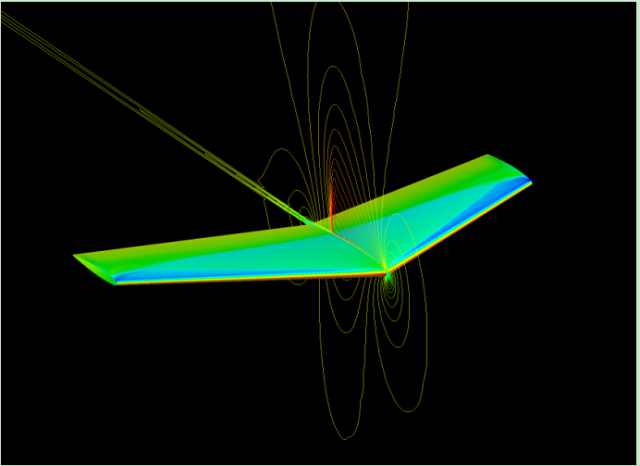

Pressure contour on wing surface and Mach contour lines at symmetric plane

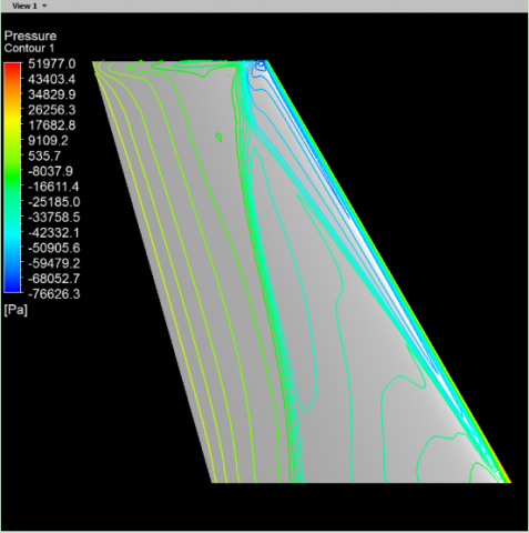

Pressure contours on the upp er wing surfac e

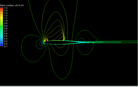

Mach contour at various spanwise lo cations, from top to b ottom: z/b=0.44,

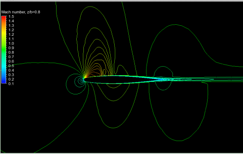

Mach contour at various spanwise lo cations, from top to b ottom: z/b=0.2, z/b=0.8

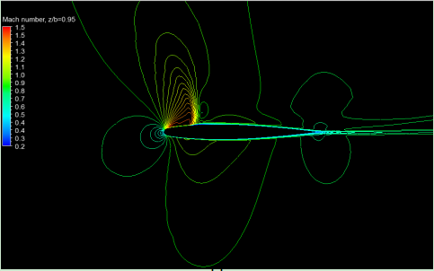

Mach contour at various spanwise lo cations, from top to b ottom: z/b=0.95
Pressure co efficient distribution at different spanwise lo cations

发表于 2015-3-26 10:59:30 | 显示全部楼层
实验和模拟结果,基本重合了呀。
,很酷。

发表于 2015-4-18 11:01:21 | 显示全部楼层
很漂亮,不过纵坐标貌似是-CP
