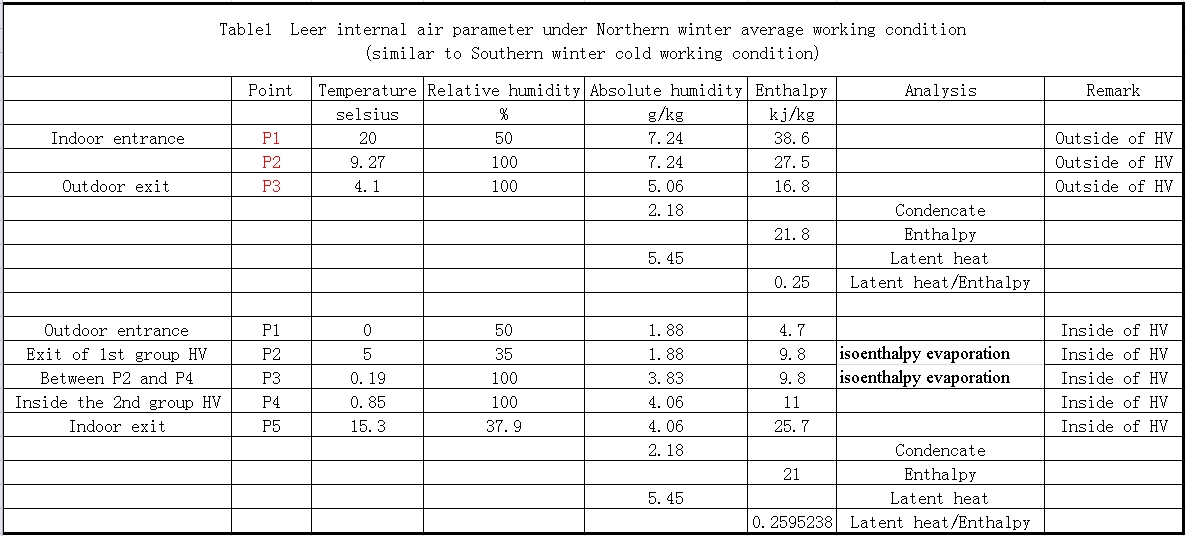

Northern winter average working condition of China
similar to Southern winter cold working condition of China
登录/注册后可看大图
This is the LEER designed standard working condition, the flow ratio of cold and hot air is 1:1, it is applicable to most of areas in China.
Explanation on Table 1 and Chart 1:
P1,P2,P3 --- hot air parameter points;  P1,P2,P3,P4,P5 --- cold are parameter points; T- dry-bulb temperature; RH – relative humidity, AH – absolute humidity;  E – enthalpy;  HV – hollow vane
1)        Hot air channel
P1 is the entrance, hot air come from indoor flow outside the hollow vane.
During P1-P2 process the dry-bulb temperature T gradually decreases, the relative humidity RH gradually increases. Because the hollow vane are made of metal material, there is no water exchanging, the absolute humidity AH remains no change. When reach P2, the RH get 100%, condensation water starts. P1-P2 line segment is the isohume, point P2is at the intersection of the isohume and saturated humidity line.
During P2-P3 process T keep dropping, RH remains 100%, the increasingly generated condensation water transferred to the cold air channel through the perforations on the cylinder under centrifugal, P2-P3 line segment is coincided with the saturated humidity line.
When reaching exit P3, T decreased to 4.1 0C, RH still remains no change, the AH reached lowest (5.06). In the above process, the enthalpy exchanged 21.8kj/kg, in which latent heat exchange takes 25%.
2)        Cold air channel
P1 is cold air entrance, the cold air come from outside, the flow inside the hollow vane.
P1 – P2, the cold air get through the first groups of hollow vane, there is only sensible heat exchange, no humidity exchange. When reaching P2, T=5, RH=35, AH=1.88. As AH didn't change, therefore P1-P2 is the AH isohume.
P2-P3 is the isoenthalpy line, the exit of group 1 HV and the entrance of group 2 HV is a “long and narrow channel”, the heat exchanging area is very small and can be considered as an adiabatic process.  The condensation water transferred from hot air channel evaporates here until reached dew point.
P3 is at the intersection of this isoenthalpy line and the saturated humidity line. Line segment P3-P4 is coincided with the saturated humidity line.
P4 is at the inside of group 2 hollow vane (HV), as the condensation water didn’t evaporated completely in the “long and narrow channel”, the leftovers will evaporate inside the group 2 hollow vane( HV), and totally evaporate along with the increment of T and AH. This point is P4, at the intersection of the saturated humidity line and next isohume(P4-P5).
P4-P5 is isohume. When the air flowing to exit, T is keep increasing and RH keep decreasing, E is also increasing gradually, until exit P5, T=15.3, RH=37.9, D=4.06, E=25.7.
During P4-P5 the whole heat exchange process, E increased 21kj/kg, in which latent heat exchange takes 26%.

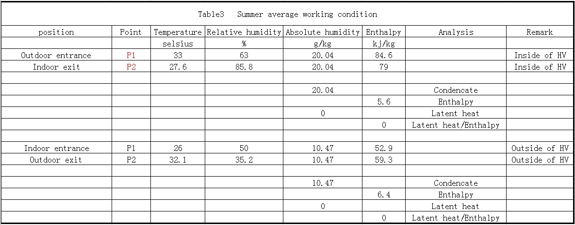

Summer average working condition
登录/注册后可看大图
According to Table 3 and Chart 3, there is no condensation water generated in summer average condition, no latent heat exchange, therefore the entrance and exit of LEER are the same as in winter; but in case of high humid weather, there might be condensation water coming into inside rooms, this is not what we want. Is it possible to switch the entrance and exit of LEER when season changes.

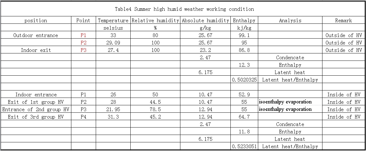

Summer high humid weather working condition of China
登录/注册后可看大图
According to Table 4 and Chart 4, different from 1 and 2, look at the blue line, P3 is not at the saturated humidity line. When RH reaches 78.5%, the condensation water evaporated completely, the isoenthalpy evaporation process of P2-P3 caused the temperature decreased to about 220C. The relatively bigger temperature difference can increase the heat exchange amount. And more exhilarating, in high humid weather, the heat exchange result is very good and the sensible and latent heat exchange rate is 1:1. It is worth doing to switch the entrance and exit when season changes even it brings a little trouble.
