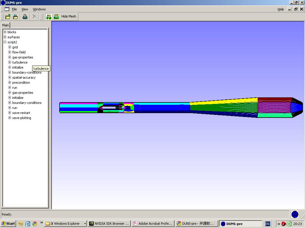

DUNS-pre is a preprocessor for the NS solver - DUNS.
It features:
1. a friendly graphics user interface
2. open .grid files for 2d geometries (duns structured grid files)
3. users can create a conn file for a given 2d grid interactively
4. users can specify boundary conditions interactively
5. can read a conn file for a grid
6. can read/modify/create script2 files
It can save DUNS  users a lot of effort to create conn files and prepare script2 files.
Any problem or suggestion, please report here.
