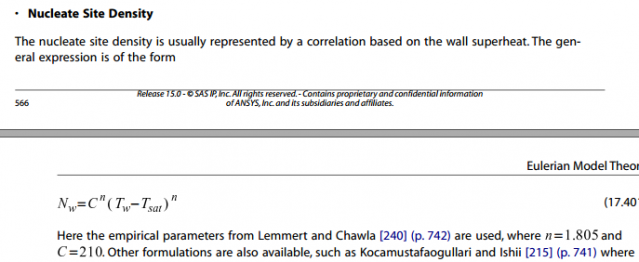

使用fluent的udf修改多相流中欧拉沸腾模型的汽化核心密度模型,根据图中公式进行修改,并根据我下面的udf进行修改。但是会把壁面的热流密度也修改成了变量(我设置了恒定热流密度边界条件),请问这是什么原因,求各位大侠指点迷津,应该如何进行正确的udf编写?
UDF that demonstrates how to compute the nucleate site density based on Lemmert and Chawla.
Can be interpreted or compiled.
#include "udf.h"
#define C_coef_0 210.
#define n_coef_0 1.805
DEFINE_BOILING_PROPERTY(nucleate_site,f,t,c0,t0,from_index,from_species_index,to_index,to_species_index)
real T_w = F_T(f,t);
real T_SAT = C_STORAGE_R(c0,t0,SV_SAT_TEMPERATURE);
real delta_T0 = T_w-T_SAT;
real nsd_0 = pow(C_coef_0*delta_T0,n_coef_0);
return nsd_0;
