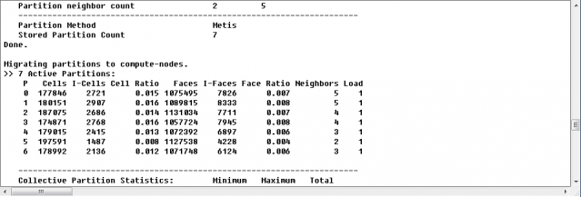

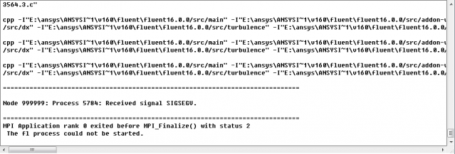

想给罐体一个在吗X轴方向上的随时间变化的加速度曲线,但解释后初始化就出现了下面问题,请问怎么解决
Node 999999: Process 5784: Received signal SIGSEGV.
MPI Application rank 0 exited before MPI_Finalize() with status 2
The fl process could not be started.
Migrating partitions to compute-nodes.
>> 7 Active Partitions:
    P   Cells I-Cells Cell Ratio   Faces I-Faces Face Ratio Neighbors Load
    0  177846    2721      0.015 1075495    7826      0.007         5    1
    1  180151    2907      0.016 1089815    8333      0.008         5    1
    2  187075    2686      0.014 1131034    7711      0.007         4    1
    3  174871    2768      0.016 1057724    7945      0.008         4    1
    4  179015    2415      0.013 1072392    6897      0.006         3    1
    5  197591    1487      0.008 1127538    4228      0.004         2    1
    6  178992    2136      0.012 1071748    6124      0.006         3    1

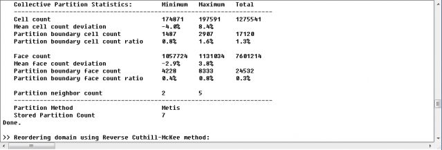

   Collective Partition Statistics:        Minimum   Maximum   Total
   Cell count                              174871    197591    1275541
   Mean cell count deviation               -4.0%     8.4%
   Partition boundary cell count           1487      2907      17120
   Partition boundary cell count ratio     0.8%      1.6%      1.3%
   Face count                              1057724   1131034   7601214
   Mean face count deviation               -2.9%     3.8%
   Partition boundary face count           4228      8333      24532
   Partition boundary face count ratio     0.4%      0.8%      0.3%
   Partition neighbor count                2         5
   Partition Method                        Metis
   Stored Partition Count                  7
Done.
初始化后出现的错误
初始化后出现的错误
发表于 2018-3-13 15:10:47 | 显示全部楼层
试一下先在单进程Fluent中做,保存后再用并行Fluent读进来。
