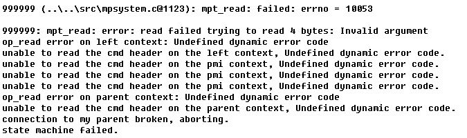

2.我在四核计算机上用fluent计算一个外流场,结果迭代到一定步数时,出现错误提示。
999999(..\..\src\mpsystem.c@1123):mpt_read:failed:errno = 10053
999999:mpt_read:error:read failed trying to read 4 bytes :Invalid argument
op_read error on left context:Undefined dynamic error code
unable to read the cmd header on the left context ,Undefined dynamic error code
connection to my parent broken, aborting.
state machine failed.

my parent broken?????? 不懂这是什么情况,观望

我用fluent计算流化床也出现同样的问题 同问
