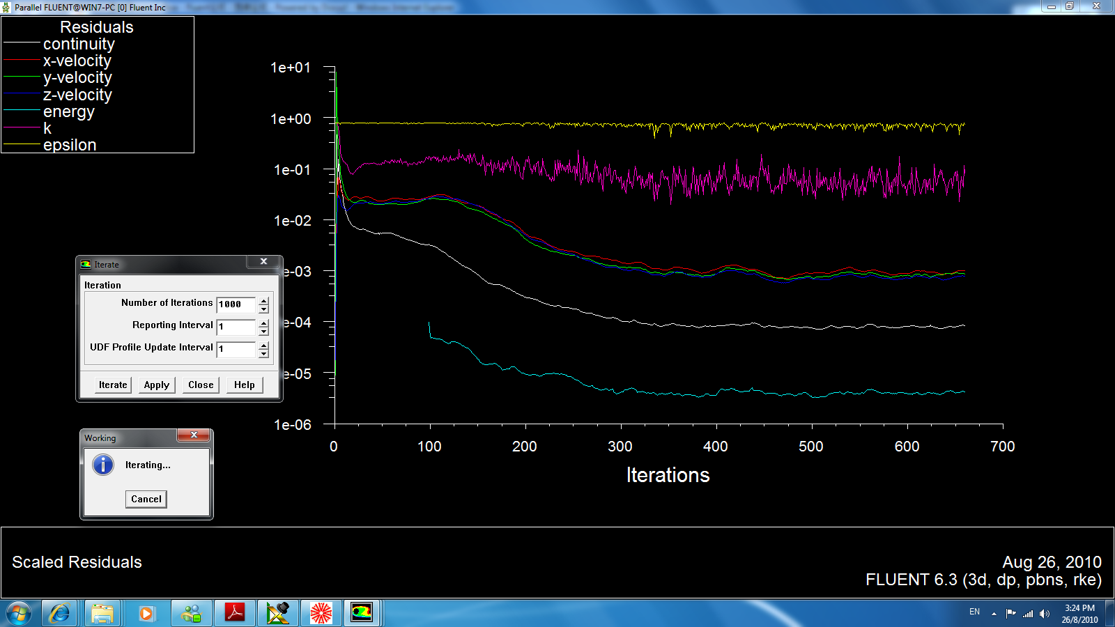

 楼主| 发表于 2010-8-26 15:11:43 | 显示全部楼层
This is the image of the iteration process after I recreated my mesh.
Somehow the k and epsilon residual are unable to converge while other show converge symptom.

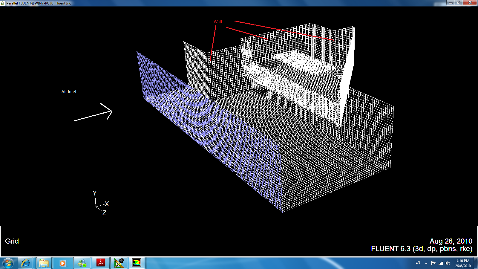

Hi, just paste some pictures of the mesh so as we can have a grasp of your model.
 楼主| 发表于 2010-8-26 17:18:41 | 显示全部楼层
I have uploaded my picture of grid. Basically I tried to simplified my model as simple as possible. I set symmetry boundary condition on 2 side while pressure outlet the top surface.
 楼主| 发表于 2010-8-26 17:21:22 | 显示全部楼层
The model as you can seen are an outdoor deck. The deck got a 4 meter glass fence wall infront which block most of the incoming wind. The reason I simulate this model is to study the opening gap at the bottom of glass wall to ensure thermal comfort around deck.
发表于 2010-8-29 16:53:58 | 显示全部楼层
IMHO, the computational domain is not adequate, its too small as to the boundary conditions cannot be imposed properly. Secondly, inlet and outlet boundary should not be placed adjacently.
发表于 2010-8-29 20:56:10 | 显示全部楼层
agree with xrs333's opinion. each dimension of your computational domain has to be at least twice of the side of the deck and the glass wall.  outlet condition is a bit tricky.  it should be far field.  but for incompressible flow, you cannot use it.  I have use a much larger domain in vertical direction, and set the top surface as a mirror.  it is kind of approximation.

发表于 2010-8-30 14:30:08 | 显示全部楼层
according to your residual monitors window, both K and ε are shaking(especially for K). in my opinion,  at first you can use first order upwind scheme for k and ε. and then ,change into the second order upwind scheme supposing the solving is convergent.
with respect to the turbulent flow problem,  reasonable  turbulent model and parameter setting are both important. sometimes the reverse flow will appear at the beginning and disappear after some iterations. so a lot more iterations may be useful for the solving.
