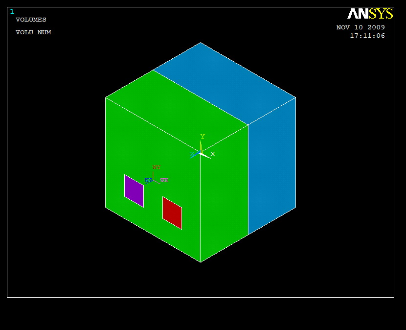

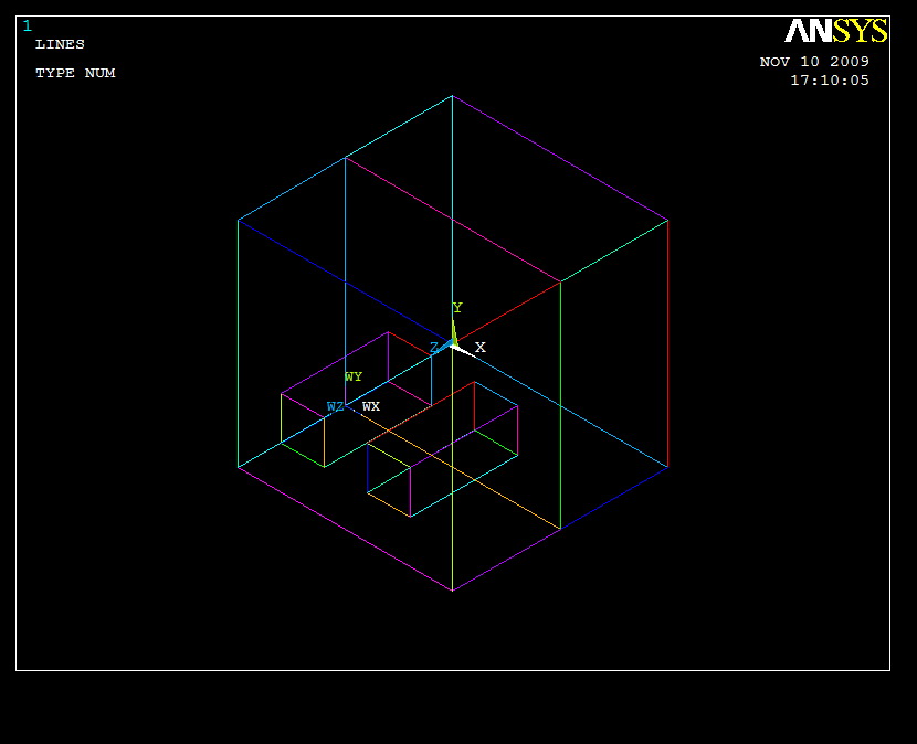

建了一个10x10x5mm的立方体,在顶面又建了两个立方柱2x2x5mm,又在顶建了一个10x10x5mm的立方体,然后和小柱overlap后和底下的立方体glue。其中底面的一个立方体和柱是一种材料,上面的立方体是另一种材料。想话网格,总是画出不规则的六面体,请教高手如何画出规则的六面体。
fini /clear
/PREP7
ET,1,SOLID45
BLC4, , ,0.01,0.01,0.005
/VIEW,1,1,1,1
/ANG,1
/REP,FAST
KWPAVE,       5
CSYS,4
BLC4,0.002,0.002,0.002,0.002,0.005
FLST,3,1,6,ORDE,1
FITEM,3,2
VGEN,2,P51X, , ,0.004, , , ,0
/PNUM,VOLU,1
LPLOT
FLST,2,3,6,ORDE,2
FITEM,2,2
FITEM,2,-4
VOVLAP,P51X
/REPLOT
FLST,2,4,6,ORDE,3
FITEM,2,1
FITEM,2,-3
FITEM,2,5
VGLUE,P51X
LPLOT
