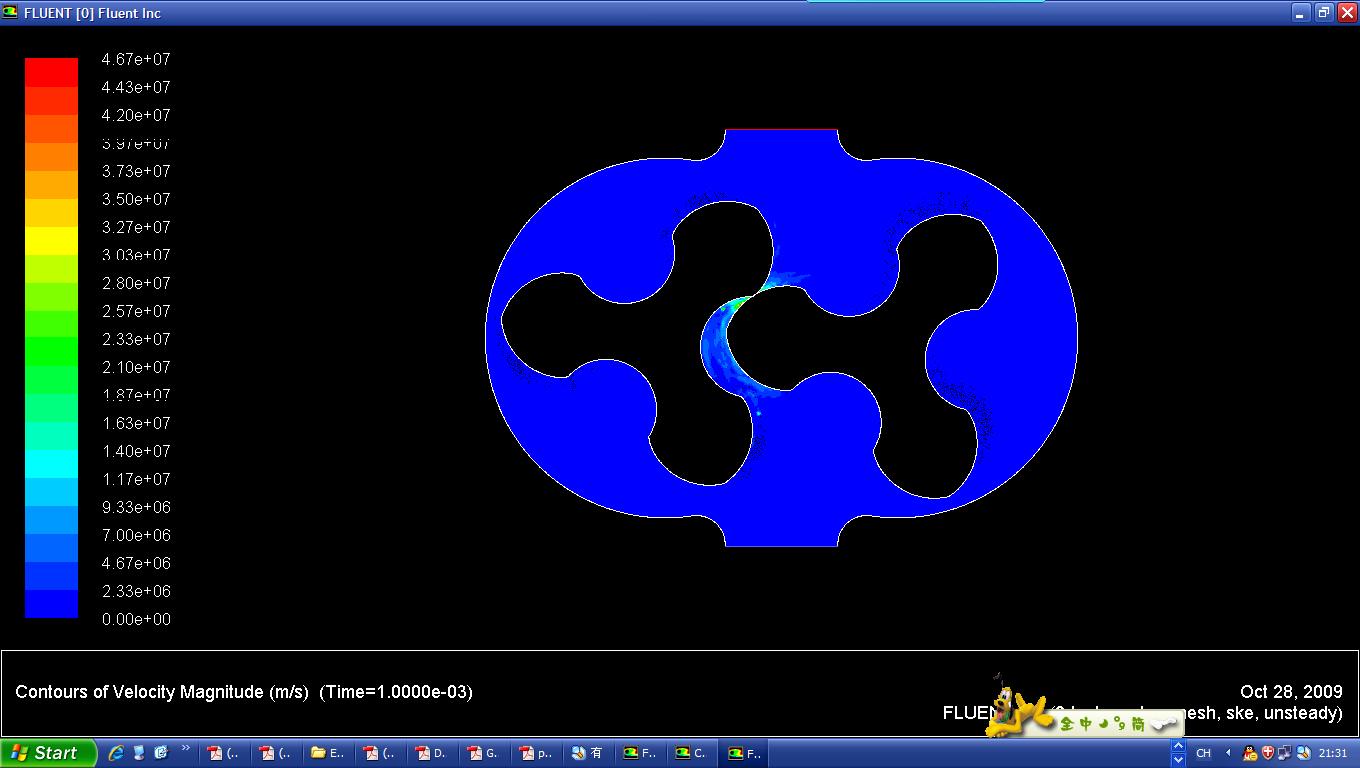

有两个齿轮怎么设置让它们一起配合转动?
我设了udf如下
#include "udf.h"
static real v_prev = 0.0;
DEFINE_CG_MOTION(movewall_left, dt, vel, omega, time, dtime)
omega[2]=104.72;
DEFINE_CG_MOTION(movewall_right, dt, vel, omega, time, dtime)
omega[2]=-104.72;
发现两个同方向转??
