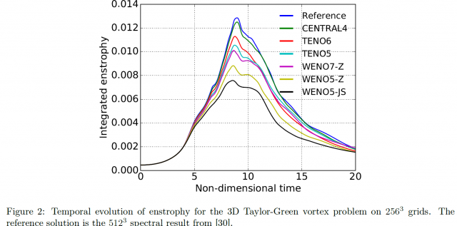

 楼主| 发表于 2018-5-27 06:33:01 | 显示全部楼层

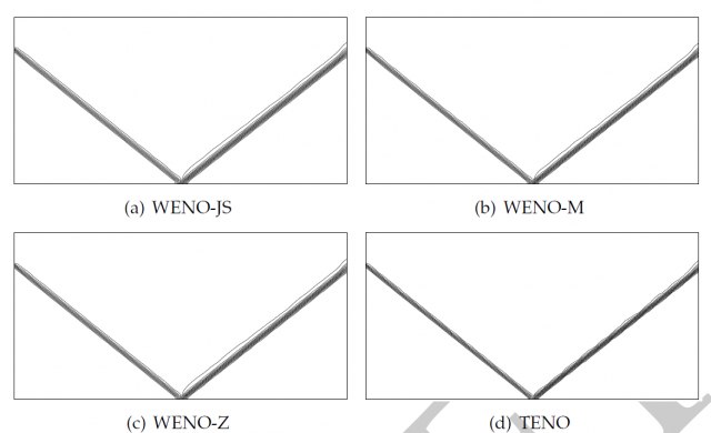

Comparisons of high-order TENO schemes

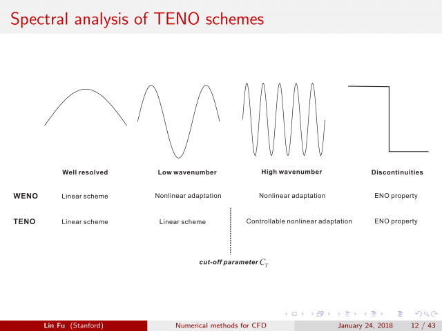

Fundmental differences between WENO and TENO scheme

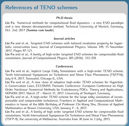

References of high-order TENO schemes by Dr. Lin Fu 傅林

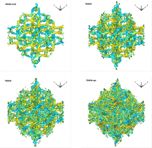

 楼主| 发表于 2018-6-17 10:10:50 | 显示全部楼层

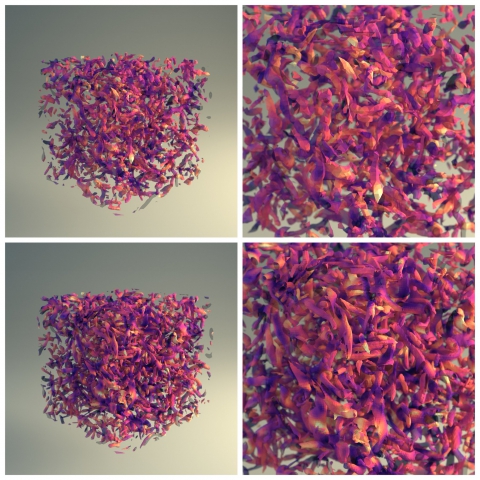

TENO schemes for implicit LES (ILES Lin Fu 傅林)

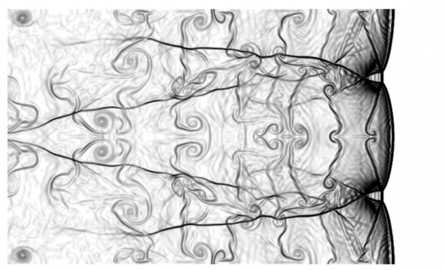

 楼主| 发表于 2018-6-26 01:32:32 | 显示全部楼层
Thanks to the collaborative work of Haibo Dong, Fan Zhang and et al., we have extended the high-order TENO schemes to very complex detonation simulations, e.g. the two-dimensional detonation with TENO scheme.

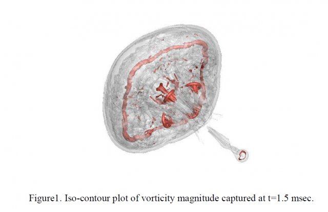

 楼主| 发表于 2018-8-13 05:01:00 | 显示全部楼层
Thanks to the work of Dr. Ory Haimovich, the TENO scheme is extended for 3D multi-phase simulation
http://www.delegia.com/app/data/ ... ETC16_Haimovich.pdf
