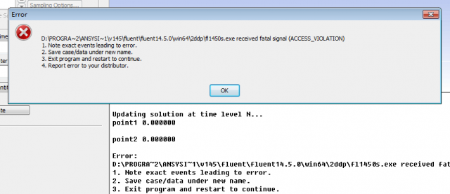

      想在fluent中通过滑移网格模拟轮机在水流作用下的自由旋转,用DEFINE_ZONE_MOTION宏和Compute_Force_And_Moment函数写了如下udf:

该udf在fluent中可以正常加载,但是在计算过程中会出现下图的问题:
最终确定是运行到上述背景黄色行时出现的问题,但却不知如何解决了。请教大家有什么办法?先谢过了。

"This function needs size of 3 for force and moment. It works in parallel and
the common arguments are the of the same type as your arguments.
In addition you have to pass the domain as first arg and a boolean as
last argument. This boolean has to be TRUE if you also call the function
on the host else it has to be FALSE."
Compute_Force_And_Moment (domain, tf, CG, force, moment, FALSE);

 楼主| 发表于 2017-11-7 15:51:14 | 显示全部楼层
回来回复一下,力和转矩数组用[ND_ND]建立后不要赋值,否则会出现图示错误
