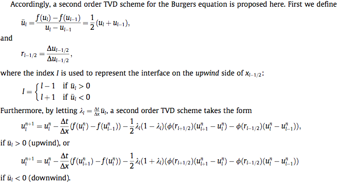

按照附件图片中的方法想用对流方程测试下其阶数,u_t+u_x=0, 周期边界,初值取 sin(pi*x), matlab 程序如下, 但是跑一会数值解的波峰和波谷就会变平掉,精度也的达不到2阶,请教为什么会有这个结果,程序里面什么地方有问题呢? 万分感谢
  1. clc, clear
  2. f = inline('u');
  3. N = 200; dx = 2/N; x = 0:dx:2-dx; x = x';
  4. dt = 0.5*dx; tend = 50; T = tend/dt;
  5. u = sin(pi*x); u1 = zeros(N,1);
  6. for j = 1:T
  7.     t = j*dt;
  8.     um1 = circshift(u,1); um2 = circshift(um1,1); up1 = circshift(u,-1);
  9.     ubar = (f(u)-f(um1))./(u-um1); lam = dt/dx*ubar;
  10.
  11.     Id1 = find(ubar>0); Id2 = find(ubar<=0);
  12.
  13.     if ~isempty(Id1)
  14.         r1 = (um1(Id1)-um2(Id1))./(u(Id1)-um1(Id1));
  15.         phi1 = superbee(r1); Phi1 = circshift(phi1,-1);
  16.
  17.         u1(Id1) = u(Id1)-dt/dx*(f(u(Id1))-f(um1(Id1)))-...
  18.             1/2*lam(Id1).*(1-lam(Id1)).*(Phi1.*(up1(Id1)-u(Id1))-phi1.*(u(Id1)-um1(Id1)));
  19.     end
  20.
  21.     if ~isempty(Id2)
  22.         r2 = (up1(Id2)-u(Id2))./(u(Id2)-um1(Id2));
  23.         phi2 = superbee(r2); Phi2 = circshift(phi2,-1);
  24.
  25.         u1(Id2) = u(Id2)-dt/dx*(f(up1(Id2))-f(u(Id2)))-...
  26.             1/2*lam(Id2).*(1+lam(Id2)).*(Phi2.*(up1(Id2)-u(Id2))-phi2.*(u(Id2)-um1(Id2)));
  27.     end
  28.
  29.     uex = sin(pi*(x-t));
  30.     plot(x,u1,x,uex,'r--');  h = gca; set(h,'xlim',[0,2],'Ylim',[-1.5,1.5]);
  31.     drawnow
  32.
  33.     u = u1;
  34.     fprintf('Computing times = %d      Total times = %d\n',j,T)
  35.
  36. end
