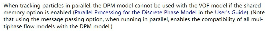

fluent理论指南里关于vof模型使用限制:when tracking particles in parallel, the DPM model cannot be used with the VOF model if the shared memory option is enanbled (parallel processing for the discrete phase model in the user's guide). (note that using the message passing option, when running in parallel,enables the compatibility of all multiphase flow models with the DPM model)
这段话具体是什么意思啊?
发表于 2013-3-16 09:30:07 | 显示全部楼层
可能是在单机并行时,不能耦合使用DPM和VOF模型。
