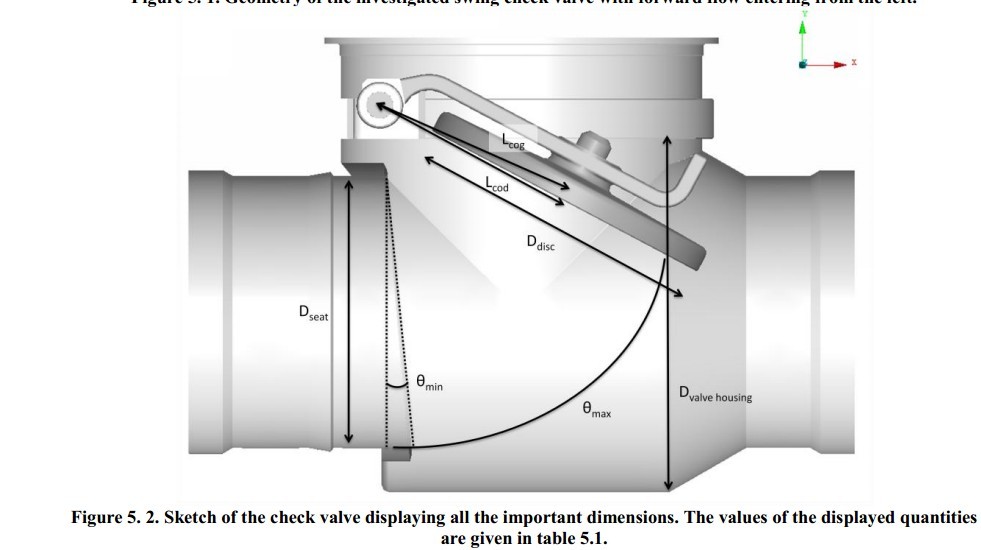

发表于 2012-8-20 11:09:06 | 显示全部楼层 |阅读模式
本人初学Fluent,而且UDF的编写基本一窍不通。有没有相类似的例子。请高手指导一下。有的话给我发一个。万分感谢啊。shang1989@hotmail.com

 楼主| 发表于 2012-8-21 14:38:59 | 显示全部楼层
#include "udf.h"
#include <mem.h>
static real omega_calc = 0.0;
static real theta=0.697777777;
/*extern real omega_out=0.0; */
DEFINE_CG_MOTION(move_flapper,dt,vel,omega,time,dtime)

/* Compute the torque due to pressure P and weight W */
torque_w= -10.06506 * sin(theta); /* -g*L*W*sin(theta) */
torque_p= 81.61488* cos(theta);
torque= torque_p + torque_w;
domega = dtime * torque / inertia;

theta=theta + 0.5*dtime*(omega_prev+omega_calc);

/* Resitrictions, make it stop at the end points*/
if (theta < 0.0872664626*1.1) /* Corresponds to 5.5 degrees */
omega_out=0;
omega_calc=0;
domega=0;
theta=0.0872664626*1.1;
Message("\nSTOP - Almost closed!");
if (theta >0.697777777)
omega_out=0;
omega_calc=0;
domega=0;
theta=0.697777777;
Message("\nSTOP - Fully open!");

omega[1]=omega_out;
 楼主| 发表于 2012-8-21 14:39:55 | 显示全部楼层
大家看看我编的那段程序里面有什么问题。。。求高手帮忙啊。往fluent软件里编译的时候总是说第三行出错。不知道是什么错误。line 3: parse error。高手帮帮忙。教教我啊。。。
