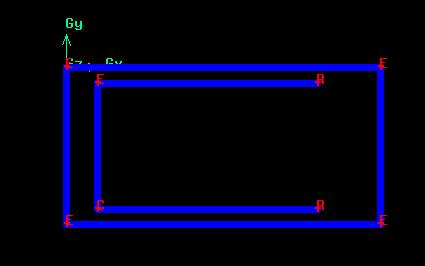

如图外面的框为wall, 里面小框的左边edge想设置成风扇fan,风扇连着的其余两边设置成wall,用的里面小框的三条边split外面框围成的face,其余区域是流体,风扇的上下两点是5和6点。mesh整个split后的face时在56两点报错,Error:The vertex 6 has more than one angle attached on face 。can't set value based only on vertex
。怎么办啊?

问题解决了,原来split选edge时必须按特定顺序(顺时针)选三条边才行。
