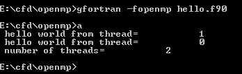

第1个程序hello.f90
  1. program hello
  2. integer nthreads,tid,omp_get_num_threads,omp_get_thread_num
  3. !$omp parallel private(tid)
  4. tid=omp_get_thread_num()
  5. print*,'hello world from thread=',tid
  6. if(tid.eq.0) then
  7.   nthreads=omp_get_num_threads()
  8.   print*,'number of threads=',nthreads
  9. end if
  10. !$omp end parallel
  11. end
复制代码
编译和运行参见附图
[ 本帖最后由 shirazbj 于 2011-7-21 21:39 编辑 ]
