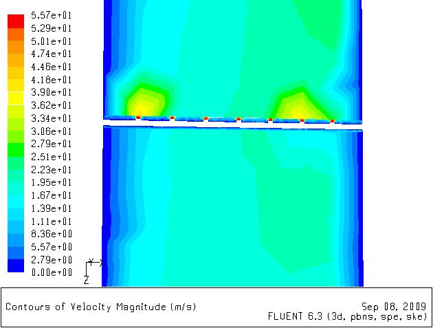

1. 显示等值线图:display -> contours -> contours of = discrete phase model / DPM concentration -> ......
2. 面积平均值文本报告:report -> surface integrals -> report type = area-weighted average OR mass-weighted average -> field view = discrete phase model / DPM concentration
3. 容积平均值文本报告:report -> volume integrals -> report type = volume-average OR mass-average -> field view = discrete phase model / DPM concentration
4. 颗粒统计:report -> DPM model -> sample / histogram |
