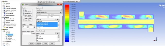

正常显示 Velocity 的状态

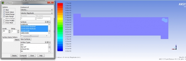

我将模型网格细化后重新计算结果,出现无法正常显示 Velocity

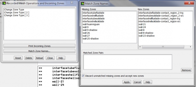

网格细化后FLUENT出现下列讯息,但不清楚要如何进行?
** Following expected zones were not found in the current mesh:
**  wall-25-shadow
**  wall-27
**  wall-26
**  wall-9-shadow
**  wall-9
**  wall-huanreguan
**  interfaceshellsolidside
**  interfacetubesolidside
**  interfaceshellfluidside
**  interfacetubefluidside
** Found Following new zones in the current mesh:
**  interfacetubefluidside-contact_region_2-trg
**  interfacetubesolidside-contact_region_2-src
**  interfaceshellfluidside-contact_region-trg
**  interfaceshellsolidside-contact_region-src
**  wall-21
**  wall-24
**  wall-8
**  wall-8-shadow
**  wall-23-shadow
** Please ensure that your current Setup is valid.
"Model Information is incompatible with incoming mesh.
Found some missing and new zones in the mesh. To make mesh compatible with settings, please visit "Match Zone Names" panel
(Mesh->Recorded Mesh Operations->Edit Incoming Zones... -> Match Zone Names...)."
请神大帮忙! 附上档案...
