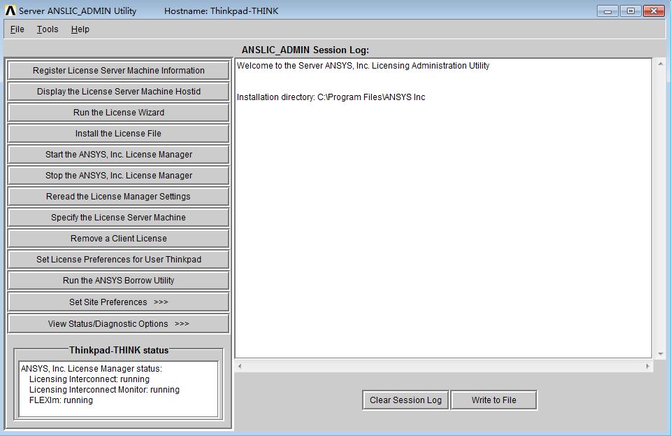

我双击tin文件打开ICEM的时候,一开始会显示初始化错误(Inilization Error)的英语,然后下面出现
ICEM CFD 13.0
Error: Capability ICEM_AM does not exist in the ANSYS licensing pool.
The specified license path:
    ANSYSLI_SERVERS: 2325@Thinkpad-THINK
    FLEXlm Servers: 1055@Thinkpad-THINK
does not have any licenses for any product. Please make sure
the license server has been started correctly.
ICEM CFD 13.0 Initialization Error:
        failed to get ansys license 10019: return code 1, Capability ICEM_AM does not exist in the ANSYS licensing pool.
You cannot use this function because a valid license for the mesh editor was not found.  Please make sure your license server is running and that you have a valid FEATURE or INCREMENT line for "aienv", "aimed", or "med".
Loading geometry file "D:/Ñо﾿Éúᄑ׶Î/}ᄊί/ᄚïÖú/icemcfdģÐÍÎļþ/two cyclines.tin"
Error opening file, D:/Ñо﾿Éúᄑ׶Î/}ᄊί/ᄚïÖú/icemcfdģÐÍÎļþ/two cyclines.tin
请问这该怎么解决?
我曾经用ICEM导入过step文件,以为可以用了,结果没想到还是出问题。。。

发表于 2012-1-2 10:49:31 | 显示全部楼层
可以直接在那个license管理界面进行查看 有三项看是不是都working 不是的话点重启或者重新安装下license 不用完全卸载

 楼主| 发表于 2012-1-5 16:53:10 | 显示全部楼层
我在证书管理器下面点了一个选项,出来了这个界面,不知道接着该怎么办?请大家指导一下!麻烦大家了
 楼主| 发表于 2012-1-5 16:53:17 | 显示全部楼层
难道需要卸了重新安装?
 楼主| 发表于 2012-1-6 07:38:45 | 显示全部楼层
昨天晚上卸了又重新装了一遍,发现就fluent打不开,ICEM可以打开了,可以导入tin文件了,不知道是怎么回事
 楼主| 发表于 2012-2-12 13:29:22 | 显示全部楼层
知道原因啦!在fluent启动界面出来的里面,show more options,更改一下里面的工作路径就可以了
