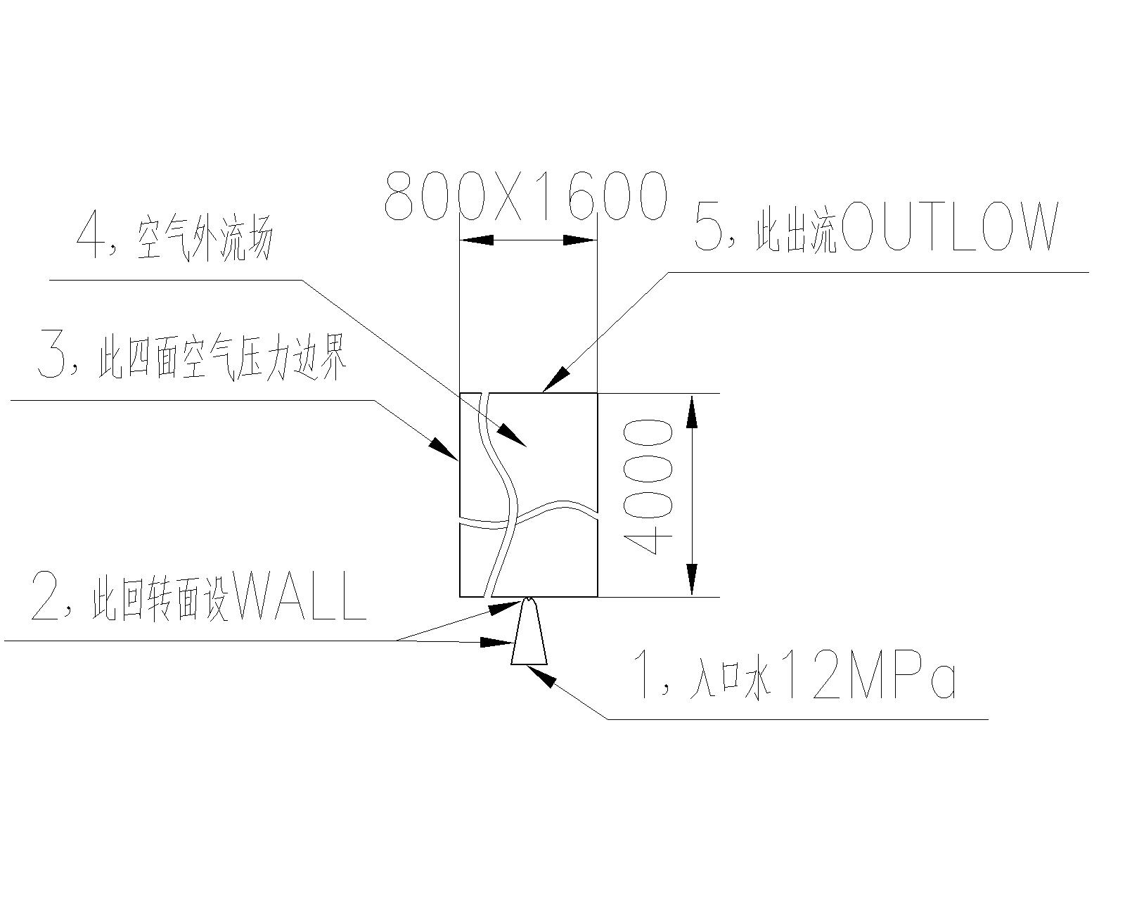

我用VOF模型想求12MPa水喷到空气中的流量,以及距喷口300mm出得雾幅宽度厚度,均匀否,我这流场边界设置为何不对?fluent提示:Both outflow and pressure boundaries are present in the
         domain. This is an incompatibility and solution cannot
         proceed until this is fixed.
几何模型对否?

回复 1# mxqwmw 的帖子
压力入口和出流不能同时使用~~~
