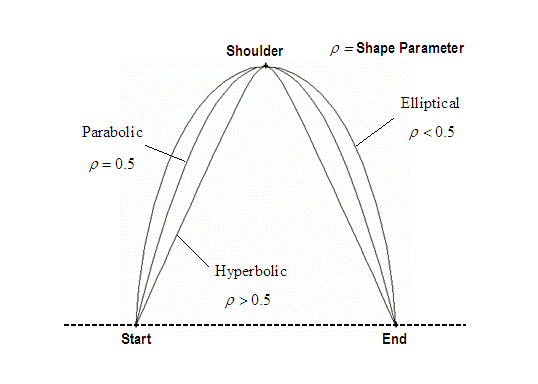

在用Gambit 画双曲线的时候。。。
The Shape Parameter specifies the shape of the conic arc edge. Its allowable values range from 0.01 to 0.99. The relationship between the Shape Parameter and the arc shape is as follows (see Figure 2-38).
Shape Parameter Arc Shape
0.01 ≤  ≤ 0.50 Elliptical
= 0.50 Parabolic
0.50 <  ≤ 0.99 Hyperbolic
这个shape parameter是怎么定义的啊?
谢谢
